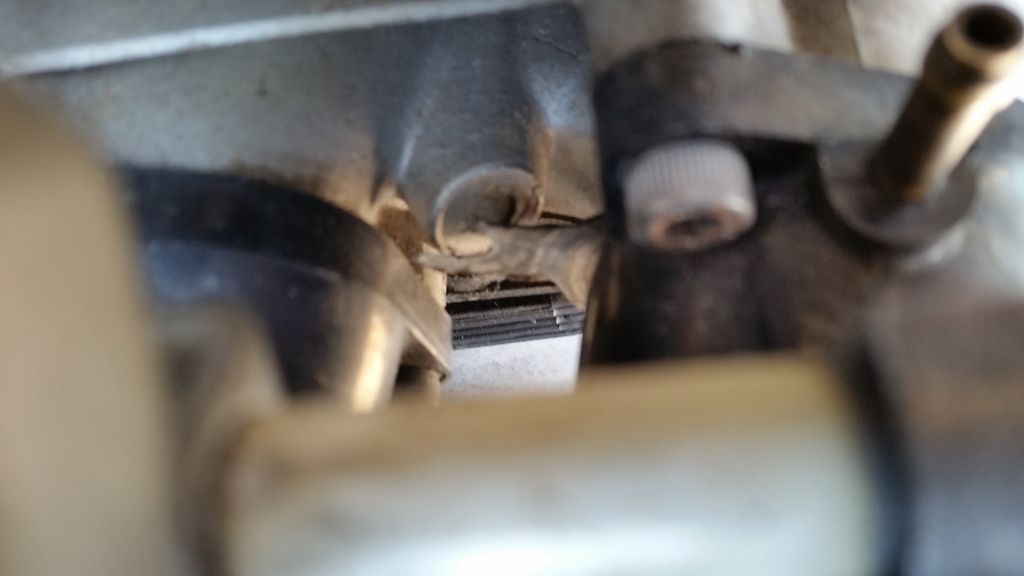

    Was doing vacuum sync with Morgan Carbtune II & notice no vacuum response out of #4 carb when turning sync screw.......well the pic reveals what is going on.......frickin is half on & half off......see pic.....
    I have #1 #4 manifold boots off to do my fuel level setting. I mount them to a board & then mount carbs to it.......rather than doing the PVC tool setup for.. Well anyway, somehow it got off when reassembling.
    I am surprised how good the bike sounds on 3 of 4 cylinders.....with that vac loss on #4........interesting.....
    Well need to correct it by loosening the allen head boots to #4 boot or yanking carbs off once again then #4 boot & re-seating gasket.........
