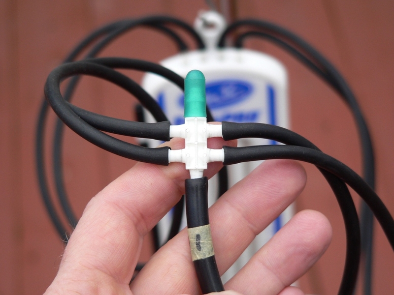

    Built this for under 20. But the problem I have is away to restrict it . It wants to suck up ATF fluid. . Any idea what to use??
  16. k-moe
    19,697
    6,787
    Plastic shutoff valves (fish tank supplies). That will allow you to adjust the amount of dampening by cracking the valves to a greater or lesser degree. You'll want to use fittings to make a manifold so you can hook all the lines up to a common vacuum source (The #3 carb vacuum port is handy) when you adjust the dampening (just like on the commercial tools).

    Would I plug off every line but one and preadjust the valves? There are 4 lines
  18. k-moe
    19,697
    6,787
  19. Ronney L Henderson jr
    Ronney L Henderson jr Member
    33
    Michigan
    Got what your saying. Looks easy enough
