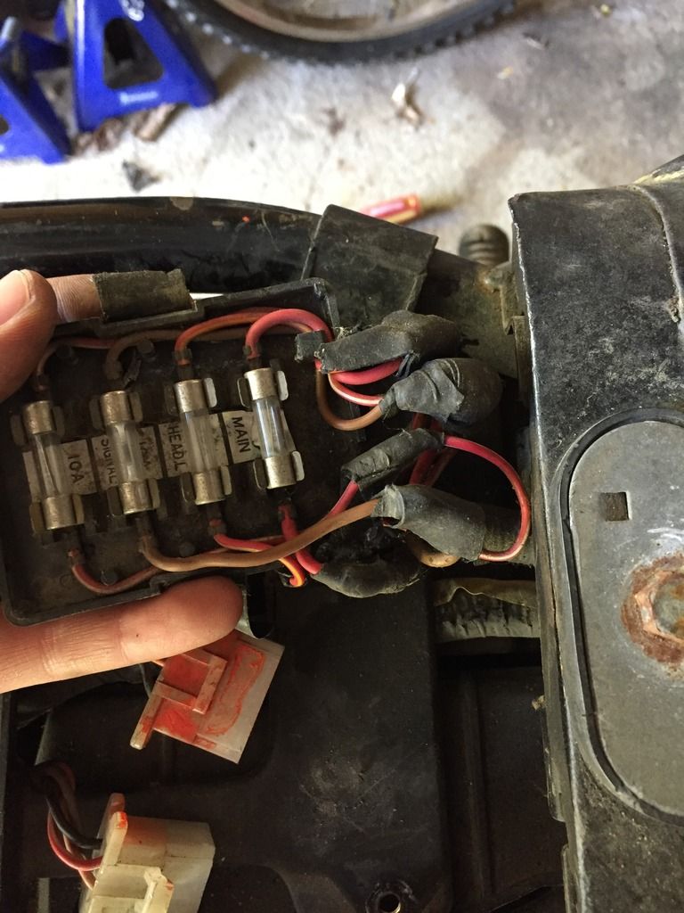

    One of the previous owners has done some funky wiring. This is the fuse box, its all taped up and the lid has been cut to 'kinda-sorta' make it close. There's a bunch of cut wires (see above post) by the headlight, and two cut wires that go towards the battery. I'm definitely going to have to rewire at least part of this bike. I also want to switch to a blade-style fuse box.

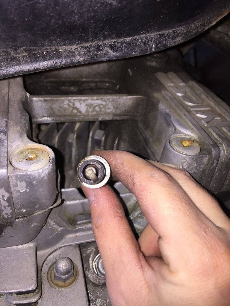

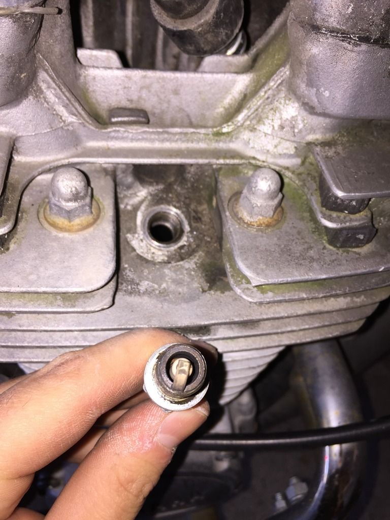

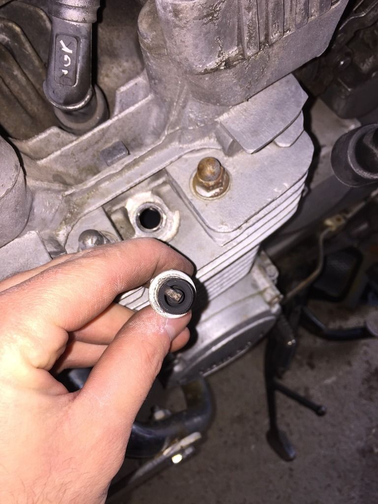

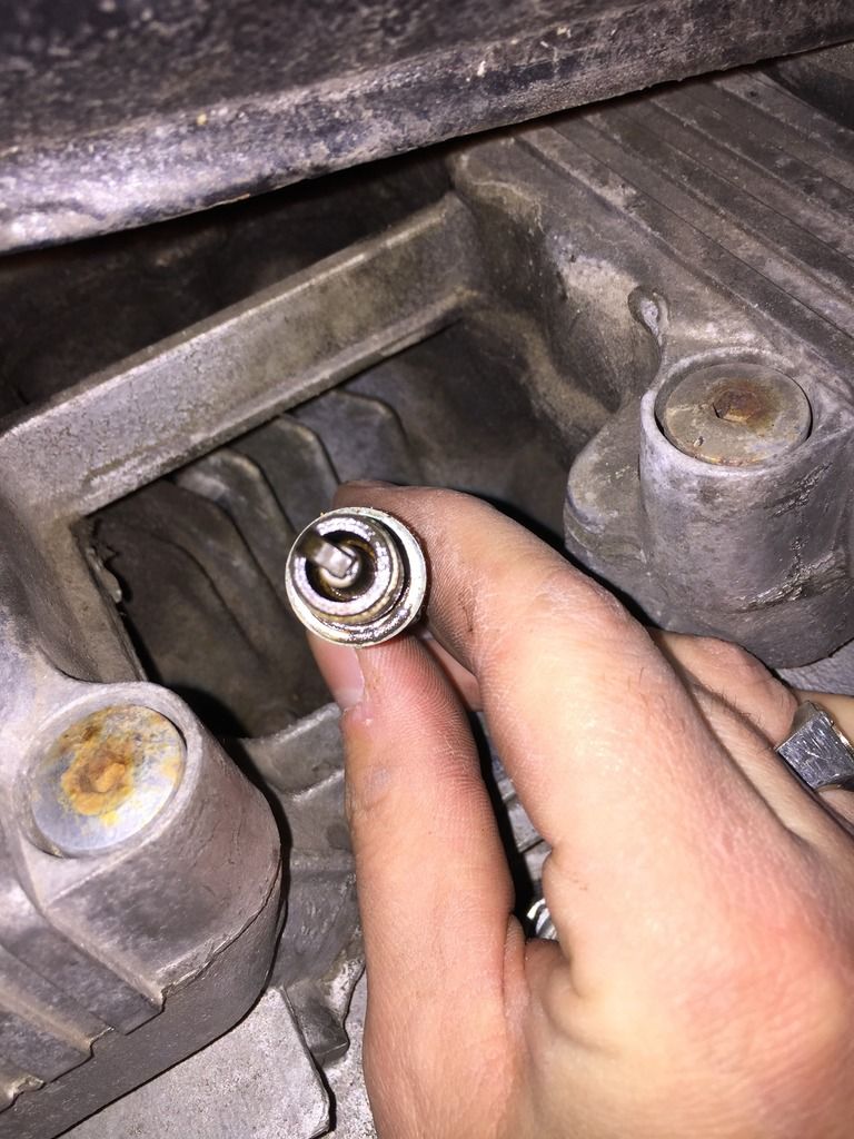

    I took some photos of the spark plugs. Plugs from cylinders 1 and 2 looks kinda of dark while the plugs from cylinders 3 and 4 are almost white and look like they were burning hot.
    Cylinder 1
    Cylinder 2
    Cylinder 3
    Cylinder 4

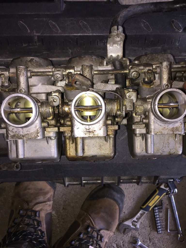

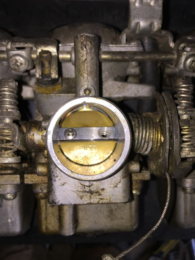

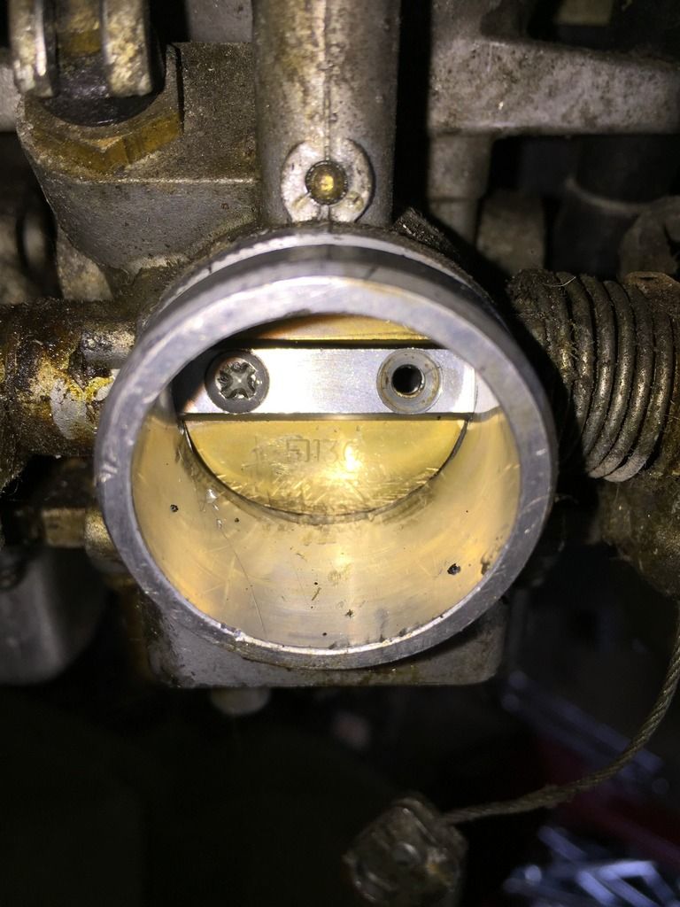

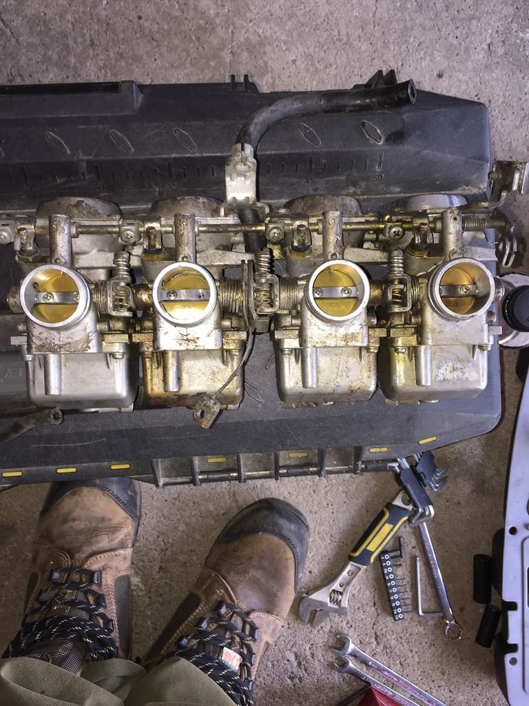

    As for the carbs, I haven't taken them apart just yet, but the butterfly valve on cylinder 3 is missing a screw and is bent out (facing away from the motor). The bore around it is also scratched up. How could something like this have happened? It looks like it was pried with a screwdriver or something. I'm going to have to go through the parts list and figure out what I need.
    As you can see from the pictures, they're pretty dirty. I certainly have my work cut out for me.
  14. XJ550H
    3,867
    big question is where did the screw go ?
  15. newfrank
    newfrank Member
    Ontario
    Well knowing my luck it probably went into the engine. I looked into the cylinder as best as I could and didn't see any knicks but I'll probably have to pull the head and take a real good look. I'll pull the motor to paint the frame and clean up the engine and that'll be the time to do it.
    EDIT: Come to think of it, the PO said he had done some carb work (rejetted) before he parked it. I'd be willing to bet he lost the screw and just didnt bother buying a replacement. I won't chance it, I'll still take off the head and have a look see but I think it's fine.

  17. Jetfixer
    Jetfixer Well-Known Member
    3,191
    1,501
    Nothern Indiana
    Oh deer. You will need a new butterfly plate this one is rather bent , a good used plate is easier than trying to straighting out bent plate. Im sure one of the group can hook you up one way or another.
  18. XJ550H
    3,867
    test the screws that remain see if they are magnetic if so you could fish it out with a magnet if it is still there.
    when the valve cover is off check to see if the valves in that cylinder are stuck open screw could be trapped in the valve.
    Stumplifter and newfrank like this.

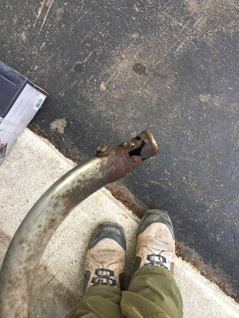

    So took some more stuff off the bike today; the rear tire, rear brake, rear fender and lights and the exhaust.

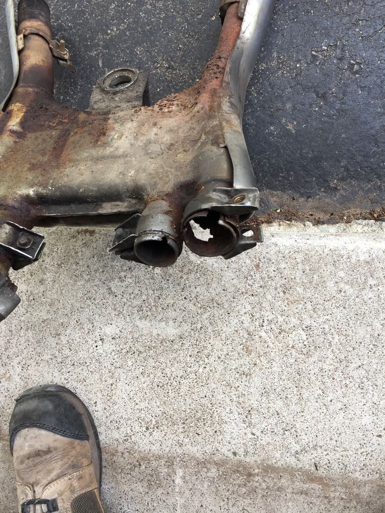

    #1 exhaust header is rusted through where it joins with the collector and the collector is rusted through where the #1 header is inserted. I've been looking for decent used exhaust on ebay. I don't like the look of the Mac 4-into-1 exhaust and also the price sucks. Can't find anything else aftermarket either, and straight pipes will be obnoxious and will probably cause backpressure issues so I'm looking for a stock exhaust I can put back on.

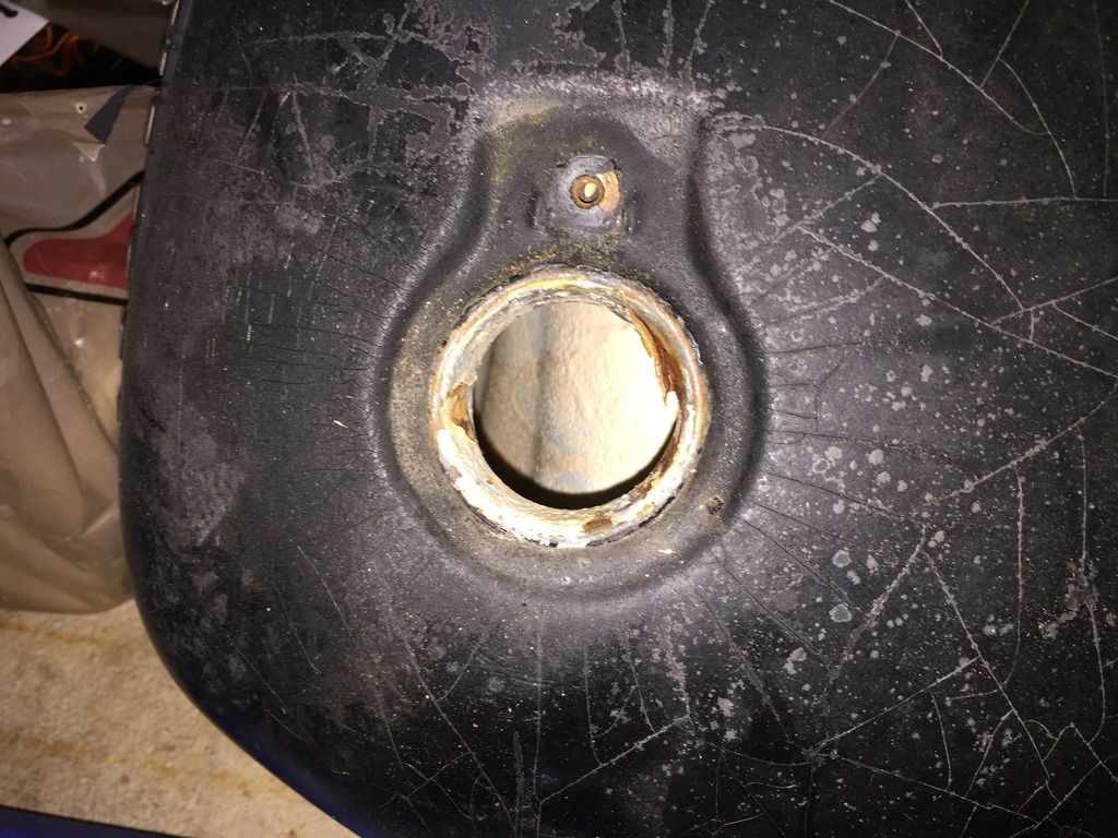

    Also, the tank was previously sealed because it was rusty on the inside. The sealant is peeling in around the gas cap lip. Can a tank be re-sealed? Or can the existing sealant be removed for new stuff? I emptied the bit of fuel that was in there and it was pretty gritty so I'm worried that it'll do some damage if I leave it as is.

    Do a search for gas tank seal or something close to that, lots of posts out there of others in the same shape. It can be taken care of one way or another. As for the TLC, just that pic, most of our bikes were found very dirty and or rusty, that is all I mean. Once you get it cleaned up she will surprise you how nice it looks.

    It's not really a great picture but it shows what I mean what I mean about the sealant that was used peeling around the edge. After reading through some posts, I'm not sure how I can fix this since its already been sealed.

  36. chacal
    9,304
    2,059
    We should have a good used original collector box and header pipe, send me an e-mail for specific part number, ordering and payment, info, etc: info@xj4ever.com or use the "Start A Conversation" feature on this website.
