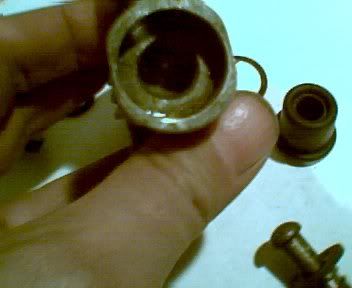

    Well, it looks like the Rear Master Cylinder needs a rebuild. The rubber seal at the plunger rod on the bottom has a spring built into it. That spring had torn through the rubber. Once I got the rubber seal off, it was all crusty old brake fluid and thick rust inside the lower master cylinder.
    But here's the thing. THIS rear master cylinder isn't the same as the one shown in the factory shop manual. The one on the bike is quite different. The bottom plunger that attaches to the brake pedal hinge, it has a bullet type end on it that inserts into the bottom of the master cylinder. This bullet end moves up into a bowl shaped cavity. I can't tell how that gets the brake fluid to pump up to the brake line that attaches near the top of the master cylinder. There don't seem to be any holes in this bowl shaped cavity going to the upper master cylinder.
    If anyone knows what I'm talking about and can explain it to me, I'd be most obliged.

    Baz... A picture says a thousand words... Got a camera?

    Well, I've take a couple of pics...
    In the first pic: Bottom view of the rear master cylinder body. You can sort of see the inside which is a bowl shaped cavity. At the bottom right is the plunger that fits into the cavity. The other end of the plunger is a threaded rod which attaches to the rear brake pedal pivot. To the mid-right in the first photo is the rubber cap that fits over the plunger and is meant to keep moisture and dirt out of the bowl cavity. What I don't get is what all this does. The bowl cavity doesn't seem to move in anyway. This might sound dumb, but how does the plunger pump brake fluid up to the brake line going to the rear caliper?

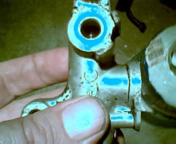

    The second photo is the side view of the rear master cylinder. On the right is the opening where brake fluid comes down from the reservoir. The round opening at the top is where the brake line going to the rear caliper hooks up. Inside the opening is what appears to be a threaded rod.
    As I said, I don't understand how the rear brake pedal pivot pumps brake fluid to this opening. Also, after reassembling, it still doesn't send brake fluid to the rear caliper.
    Thanks in advance for any help.
