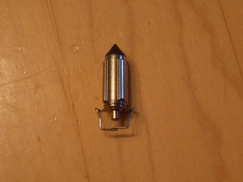

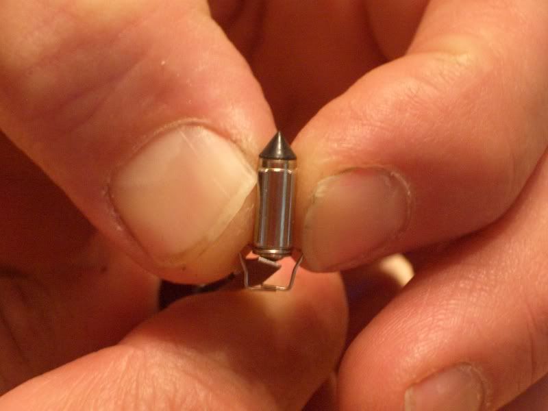

  27. ouchie
    ouchie Member
    91
    Figured this would make comms easier...
    "Cap" is on top...."Plunger is on the bottom"
    "Plunger" depressed, no movement of "Cap"
    All 4 new ones are like this, as are the old ones that I replaced.
    So I agree, I would think that the plunger moves the cap to close the opening of the seat...though I do not know that for a fact, it is educated guess.
    OR
    Does the entire needle move with the float and the plunger has another purpose?
  28. theadbrewer
    theadbrewer Member
    222
    Roseville MN
    It doesn't take very much pressure to stop the flow of fuel. As far as I can figure the spring loaded plunger is there to give the float some extra movement while still closing the valve. I had a Kawasaki with float problems it turned out to be that plunger was stuck up in the needle and not stopping the fuel flow. Cleaned and freed the plunger and the problem was fixed.
  29. ouchie
    ouchie Member
    91
    Okay, I just cut open one of the old ones and yeah, that's what the assembly looks like it does...keeps some "backpressure" on the float.
    The cap is set on fixed stud on the top and the plunger goes into the hollow cavity of the needle but not all the way thru.
    Makes a lot more sense now that I have seen it.
  30. ManBot13
    ManBot13 Well-Known Member
    1,592
    177
    Fairfax, VA
    Agreed with threadbrewer. The entire needle is actuated by the float to shut off fuel flow. I don't think my float pins have that "plunger."
    I seems like a nice design tho, as it probably prevents a bending in the float tang if the fuel sloshes around and the bowl fills with more fuel than intended and increases the pressure on the float needle. <-just my guess
  31. bigfitz52
    Those are the "spring-loaded, viton-tipped needles" Rick was referring to.
    The "spring-loaded" plunger on the bottom is only found on top-of-the-line float needles. Most are simply solid; the spring plunger does exactly what you think it does; puts some "preload" on the float valve. Another reason they need to be wet-set; the amount of that preload required for a particular needle to shut off fuel flow can vary from needle to needle.
    Adjusted properly, those work much better than solid needles.

  48. RickCoMatic
    Might be that those Float Pins aren't the right ones.
    Look at your Wire Clips.
    Those are for a Float with a NARROW "Tang"
    Narrow Tang: ==> ()|....||....|()
    Your Wire Clips probably need to fit a WIDE Tang Float.
    Wide Tang: ==> ()|...|::|...|()

    ummm.well the needles are from Chacal and for hitachi carbs...how would I go about getting different clips that fit both the needles and the tangs?
    I do have 3 off my OEM needles... I'll check those tomorrow and maybe swap em out then just pick up another OEM needle used and swap the clip from that one?
