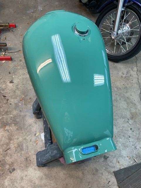

    Paint on the fuel tank got damaged and I decided that Ford grabber blue looked a lot better in my head than in reality. So cleaned up the sore spots and repainted something called Lexington Green which is still kind of funky but not nearly as ostentatious.
    And, hopefully, drove a stake through the heart of any and all potential remaining vacuum leaks by removing and reinstalling the intake boots with Permatex Motoseal gasket maker. One thing I've learned through this, using propane to find vacuum leaks does not work versus small, directed spritzes of carb cleaner.

    The paint on the tank came out pretty nice. The local auto paint store mixed up the base coat in an aerosol can along with a 2K aerosol clear coat that's supposed to be fuel resistant, at least to the degree a factory base coat/clear coat would be. The petcock needs to be rebuilt anyway so I'm going to let it cure for a week before sanding and polishing.

    Today, sanded and polished the paint on the fuel tank. It came out real nice. The only real downside to the 2K aerosol clear coat is it's an aerosol can so it doesn't feed properly when spraying at an odd angle. Like when you're spraying the top of a fuel tank that's sitting on a sawhorse. So there were a few specks and spittle spots that came out once it was sanded. In hindsight I should have hung the tank vertically, but after 600, 800, 1000 and 1200 grit wet sanding and buffing with some Meguire's ultimate compound it looks far better than what you might expect out of a $100 paint job done in a garage.

    To get a real good finish out of rattle cans , boil a pan of hot water let cool for 15 to 20 mintes . Put the can of paint in water for a few minutes, take it out shake it up several times , put it back in water for few more minutes. Remove from water shake it up and spray in even coats . The heat increases pressure in can and thins paint . JUST BE CAREFUL , you don't want the can to explode .

    Roger that, I did the hot water immersion trick with the base and clear. The clear has a smaller aerosol compartment you puncture from bottom to release hardener so I'm not sure how it feeds. It takes three coats - one light, then a medium coat, then a heavy coat to finish. I started on the top of the tank on the last coat but even with half a can left it was sputtering a bit at a ~45° angle. Probably why most spray guns feed from the top.
