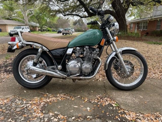

    Slapped the tank back on and took her for a spin. Need to wait a couple more weeks to wax the tank and reinstall the tank emblems.

    You know what is a problem with Maxims, at least with the original seats? They always rub on the back end of the tank and ruin the paint finish.

    Right, I had the upholstery shop bring the front lip of the seat back about a half inch so there's a bit more space and it doesn't press against the tank quite as much.

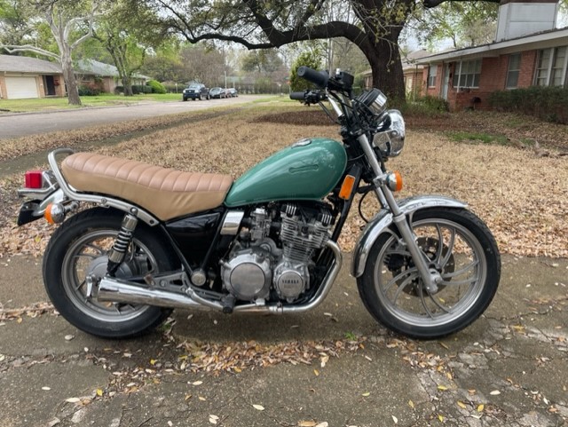

  6. XJ650inTexas
    XJ650inTexas Active Member
    153
    74
    Dallas
    Spoke wheels!
    [​IMG] [​IMG] [​IMG]

    Nice job looks great

    I am not fan of having spoke wheels but I do have to say that does look Sweet!
