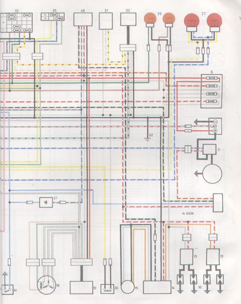

    I have a white and red striped wire coming from the wire loom near the battery and it has another wire connected to it from the PO. It is not connected to anything from there. Any ideas where it goes?

    Could be a battery sensor bypass to keep the computer from triggering the BATT warning. This should give you an idea of what's up:
    Battery Sensor Bypass kit

    yep, definatley battery level sensor wire , it attaches to the middle cell on the battery,(if you have the correct battery)
    shown here in the middle of the battery

    Actually don't do that if you have an XJ with the systems monitor computer. A direct connection of that lead to the battery will result in an over-voltage condition that will damage the monitoring system.
    OP:
    Click the link for the bypass kit. You can get the parts locally if you are comfortable doing the soldering work yourself. Otherwise the kit is a good buy. Once installed the battery light will come on if the battery voltage drops too low.

    You say dont directly attach it yet that is exactly what the directions for the bypass kit say.
  8. Polock
    2,101
    the bypass wire is more than just a wire
  9. k-moe
    19,697
    6,787
    The bypass kit includes a resistor to drop the voltage down, as well as connectors so you don't have to do any soldering (if you so choose).

    Ah i see. Any idea on the resistor? I have no trouble doing the work myself
