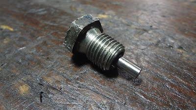

    also, not my image, but this was the oil pan drain bolt:
    the one from chacal felt like it was "too big". I fought with it for probably ten minutes trying to get it to go in, best I could do is get it to "grab" something right on the outer lip of the oil pan entry way with two fingertips but I couldn't easily tighten it with my 2 fingers so I stopped, not wanting to injure anything. This bolt went back in seemingly fine.

    More than likely the oil filter bolt was filed to get it square again.
    So 12 becomes something smaller.
    You should lay the old and the new sump bolt into each other's threads to check. Clear picture of both side by side also maybe would be cool to see.
    At any rate get the old stuff back in and forget the upgrade till you've had a few rides at least.

    So I spent the entire afternoon driving around trying to find a m20x1.5 tap to clean the threads, and absolutely no one nearby that's open right now had one in stock. I also debated getting simply an m20x1.5 bolt and making the above example with my dremel. There is still a decent amount of threads at the end, and on the right hand side, and parts of the top. However, I couldn't find an M20x1.5 bolt. I could find plenty of SAE bolts that general size, and some M20x2.5 but nothing what I was looking for.
    So I realized, there's an old oil filter housing bolt I have, that the intent was to replace anyways. I didn't find any thread pitch feeler gagues, but I did find a single store that carried some M20x1.5 nuts but not the bolts, so I brought those in and checked both old & new housing bolts, and they were a perfect match. However, (see images) I did notice on the original bolt some of the threads have been smushed (this would have been PO, I hadn't reused the old bolt whatsoever before now), which would explain at least some of the potential thread damage from the PO's.
    So with no other things to do, I used my dremel to turn this bolt into a thread cleaner, making sure to cut out the part that was dented on the bolt so it wouldn't harm the threads. I also used a jewelry file to clean up any burrs on the edges of each individual thread that was touched by the dremel.
    I would then use some blutack inside the housing, and remove it, getting as many metal fragments and some threads out as I could. I would then, using two fingers only, screw the bolt into the housing. As soon as I got some resistance, I would back it out completely, then clean the threads with some blutack (the motor oil seems to cause the blutack to deteriorate and get very sticky, so each time I did this was basically disposing of the bluetack after.) I would then use my fingertip to insert without hitting the walls, and drag my finger back out to see if there were any metal shavings or particulates.
    At this point, I've got about, most of the way in there, but I'm hitting a "wall" where I can't finger tighten it any further, and, testing with where the filter cover would be, the bolt has some way to go. At this point, I am feeling confident enough that the current placement of the bolt being dry fit into the hole, is not currently cross threaded. It goes in with little effort, as one would expect when you're bolting into something with the same threads, such as testing with that correct nut earlier in the store, i can wiggle it a little more than I would normally like when it's early in its insertion, but that behavior dramatically stops as it goes in. Wiggling does not drop anything out of place, so I feel reasonably confident that it is not "skipping" and staying within the threads. Every time I do this, I remove the plug entirely and clean the threads with blutack and my finger and so far it's coming out clean.
    However, I've been reticent to put any more pressure than required when cleaning the threads past this point. It's stopping likely because there is probably a part of the thread that is bent somehow, but I can't physically see where that might be. Based on the state of the threads, I'm feeling good that the dryfit attempts I am doing is not causing further damage, or is cross threaded. But whatever is happening in that last 4.5mm~, which also to my eye, looks pristine, is preventing the bolt from finishing it's journey. If I can just get past that hump, I can put the oil filter back on with the new bolt, fill oil, and check for leaks.
    As some of my friends and I have been talking about, if there are no leaks, then I'm good enough to at least get the bike running again. (though there is the concern of thread damage & vibration coming loose, and the cheapest option appears to be JB Weld, at least as a temp fix, though the "real fix" appears to be a Time Sert, which is like a godforsaken $315 USD)
    I think I'll use a wrench in the morning, very gently, to get past that one bit that seems to be giving issues getting the bolt back in. As has been pointed out to me, if it works, good. if it doesn't work, then at least you tried to clean it up and it was going to need to have a time sert anyways.

    You were 100% right btw
    it's not just filed down, the whole head was, and the bolt head is clearly slightly twisted

    The problem is that in some Yamaha manuals, the torque spec for that bolt is something like 30 ft-lbs.......the finned cover itself has the proper torque value cast into it, but most people don't pay attention to it.
    >>>> The proper torque settings for these bolts on all XJ engines (except 1100cc) is 11 foot-pounds, and no more!
    So between the distorted threads and twisted bolt head, we would be safe to conclude that someone massively over-tightened that bolt and that's what stripped the threads in the case. Screw threads engage each other at an angle, with the side of the threads of the screw interacting with side of the thread in the (in this example) engine case and "lock tightly" against each other....and that's how and why fasteners hold onto to their mate. Over-tightening a threaded fastener will at first DISTORT the v-shaped threads----and this typically happens to the softer metal (in this case the crankcase threads) and then finally rips the threads right out of the (softer) metal. The cover bolt is made from steel, and while its threads may get slightly distorted from over-torquing, they may not be damaged/distorted much, at all......it's the soft-metal threads in the crankcase that will be "taking one for the team".
    At some point in time, you're going to need to address those threads in the crankcase. Missing/sheared threads in the crankcase are not going to allow proper holding pressure that un-damaged threads would, even if you can (at the least) un-distort them using a tap of a new bolt to try and "straighten out (or straighten "up") the damaged threads. And since the thread-to-thread "grip" is reduced, you stand a fair chance that while riding down the road one day, the vibration from the engine and the "looseness" of the thread fit could blow that bolt right out of there, with a catastrophic loss of oil directly in front of where your rear tire is about to go......and that would be a Very Bad Thing(tm) that could happen to you in just an instant.
    Remember, the filter cover (and thus the bolt threads and case threads) are under a good bit of oil pressure when the engine is running----up to 70psi or so----so there's 70psi pushing on the cover, which is also pushing on the bolt and pulling on it's threads, which in turn are pulling with that amount of force against the threads in the crankcase. Take your hand, and on a bathroom scale, push down on it until the scale reads 70-pounds......that's the type of pressure acting on the cover, the bolt, its threads and the case threads.
    Wow, $ 315.00 for a time-sert...........I'm in the wrong business!

    I think I'm going to try the spin-on kit. I've cleaned the threads about as much as I can.
    If you look at the new bolt, see attachment, you can see where I can dry fit it until finger tight.
    If I'm correct, this is roughly where the gasket would be touching until you start to torque it down. There seems to be threads a little bit further in that I can't seem to reach with the bolt, which I'm thinking might be by design. I'm not sure that you're able to bottom out this bolt by hand.
    Because of the clearance of the headers, I understand how this got cross-threaded in the first place and overtorqued, because there's only like the tiniest bit of clearance with the oil filter assembly, and the little lips that are on the fins, that then catch on other parts of the bike
